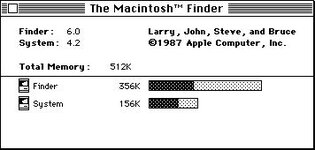

It's always good to see the 256K appearing on "About this Macintosh"! Moving on.. System 4.0 will boot on both the Mac 128K and Mac 256K, but on Mac 128K you can't run anything, even running the calculator just generates an alert to say there's no memory.
I was a bit puzzled as to why the Finder is version 5.4 for System 4.0, but was 5.5 for System 3.3. Running System 4.1 is OK on the Mac 256K, but hangs again on the Mac 128K. System 4.1 finally presents the (Restart) button when you shut it down!

I'm a bit late to the thread, but I thought I'd add my bit of info:
https://apple.fandom.com/wiki/List_of_Mac_OS_versions is the result of me untangling early OS versions based on my own recollections and talking to people / reading people's remembrances of the period.
System 4.0 is a general public release (System Software 2.0) following on as an update to System 3.2 (System Software 1.1). System 3.3 was developed in parallel, specifically for the AppleShare Work Station for the Mac 512k. As a result, 4.0 got some of the updates from 3.3 before shipping, and they were both slated to go out with Finder 5.4. And the initial disks did! But then Finder 5.5 came along; the 2.0.1 GM including System 4.1 had already been finalized, but the new 5.5 Finder was also included with a second wave of the AppleShare Work Station floppies, ensuring that Mac 512k owners running AppleShare Work Station got the 5.5 fixes that otherwise were unavailable to 512k users, as System Software 2.0.1 with System 4.1 didn't officially support the 512k, requiring a 512ke or later.
So being able to boot the Mythical Mac 256k right up through 4.1 is actually quite impressive! 4.1 with the default Finder and extensions is supposed to require more than 512k to run any applications.
