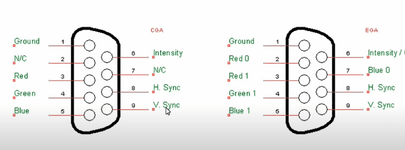

Here's the DA-9 pinout that I've been using. This is the view you get by looking at the female connector on the RGBtoHDMI as well as the view from the interior of the DA-9 male connector as the wires are soldered to the pins.

J12 connector schematic on the SE/30 logic board (leading me to believe it's +H+V polarity; I've tested them all already anyway)
Mu0n
Ok I'm an idiot. wire colors are hard to get right past midnight. I inverted hsync and vsync on the J12 because I thought I could match colors between the SE/30 and my stuff. Still have to tweak some stuff but I'll post my results when I'm done!
