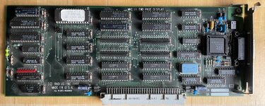

Just optained a nice Q650 with a Toby and Radius TPD II Card. I have not found any specific info about the card. I guess, it is a 1-bit card and runs at 1152x870 as this is the standard apple two page resolution. however, I can‘t get it to run without a greenish screen. I am using the 2 row 8 dip adapter and tried 1152x870 with setting for sync on green, comp. sync and separated sync. Still only showing nicely green…..
Any ideas?

You need to tie red/blue/green together at the monitor cable end to output Black and White from the card if you have the same problems I had hooking up the SE version of the Radisu TPD
Date on the card suggests single bit, but that DA-15 connector shows at least the tiniest bit of hope for GS. Older units had coaxial hookup:

Coloruser
@Trash80toHP_Mini thanks for the link to your post. the mac rescue of denver was the only reference that I‘ve found as well. Let me see whether i can cheat a VGA cable to combine RGB to one.
