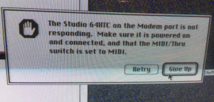

yes the 64XTC works fine on a windows computer!!!!!!! recently hooked it up to a pII 266Mhz slot 1 440bx board running windows 3.1 works 100% running windows 95 works 100%
back to the 5200CD...
for the record there is no Modem in the commslot
i just pulled out the motherboard to check... theres no commslot modem installed
only a Farallon PDS network card that i ordered from Ebay
the modem interface is connected on modem serial port
the printer port has nothing connected
the scsi is attached to an external ZIP100 plus which works fine
its connected to my local network via 10BASE-T port on the PDS card

that being said. i have just now installed the serialDMA extension and i thought at first that it was crashing my system; but no.. its fine.. and ive got the extension activated
im just trying to get a proper MIDI app installed to do some realworld testing!
fact: when i first tried to install this version of the serialDMA extension, my performa froze on startup screen but its working now?? strange
