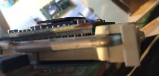

I finally managed to snag a 604e zif from one of those IBM servers.  The chips were usually just included with their motherboards (which I didn't need or want), but one finally came out as a lone chip.  It fits in well, dropped straight it.  Although, as the picture shows one corned is slightly raised, not by much and I'm sure the pins are still making contact.
I haven't actually ran the Powerbase with it yet as I'm having trouble finding a heatsink/clip to fit.  I might end up fabricating up something crude but functional.

Beware, good chance of magic smoke if you try this. It's very unlikely the pinout is the same between an IBM and a Mac.

Oh, its been done in a Beige G3 by a braver soul many moons ago.  It performed poorly due to the fact that there isn't a way to add the L2 cache it needs on a beige's motherboard, I believe.  I don't believe he took it any further.  Its an interesting project but doesn't really have any actual benefits.
