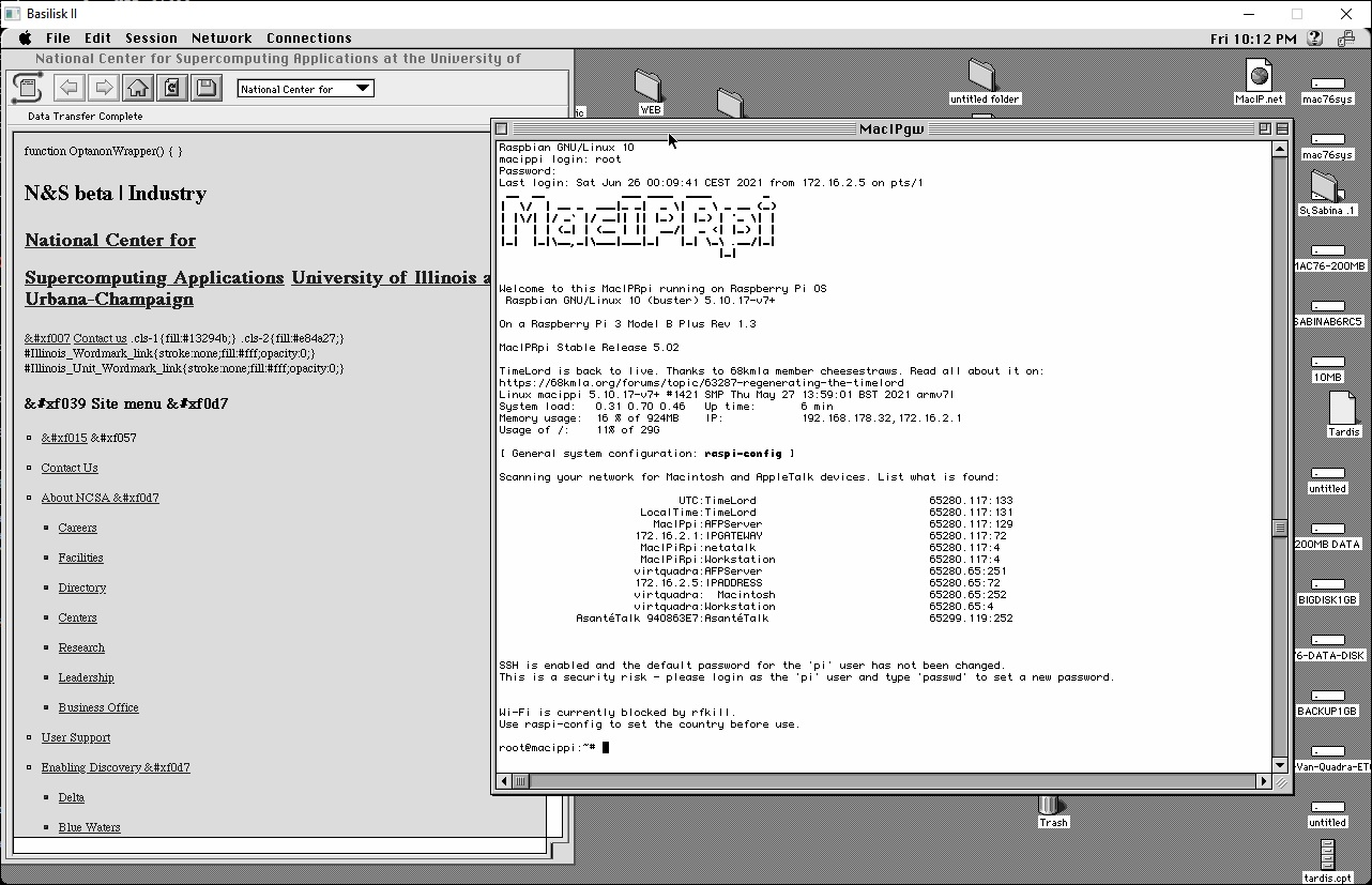

mactjaap
Knowing < jack, I'm curious about your image. Is it set up with Mac emulation as shown? If so, what System is up and running out of the box?
Installing I/O Board/Compute Module 4 in a dead Duo 280, not so worried about networking. If not, are there any images with Mac emulation/Linux ready to go out of the box?
Ah. You mean this picture?
No ... not included. This is just how a telnet login looks to the MacIPRpi and a browser window. Just to show you can use MacIP over AppleTalk. My settings are these:
172.16.2.1 is the MacIPRpi with Netatalk and macipgw running on it.
( printing is now also enabled by default in the latest beta.)
