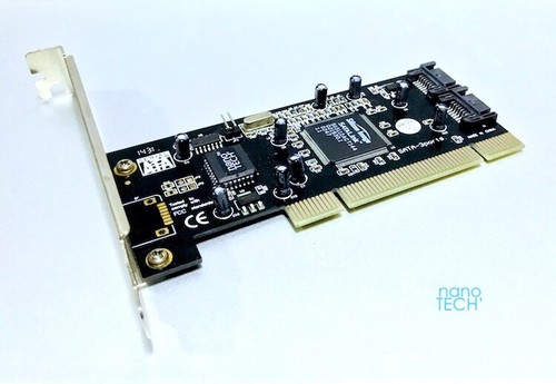

As an alternative, I can really recommend certain SATA cards: They are incredible fast and bootable!

I can confirm SATA works with my Apple Workgroup Server 8550 with System 7, Mac OS 8 (including 8.6), 9.1 and 10.3. It will most certainly also work with your G3. However, you must carefully choose card and firmware.
