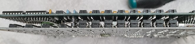

mg.man
Slightly OT, but a few years back I acquired an original Macintosh with a similar upgrade - first the "piggy-back" upgrade to 512k, then a 1.5M board placed on top - for 2M total. The company behind this upgrade was Perspect Systems, Inc. Not much out there in web-land about them.
Here are some pics :
