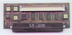

Accidentally ran across the remains of my third adapter. Fumble fingered attempts to remove the connectors for reuse fail yields destructive removal of same for PCB examination. Looks like four layers of traces, P&G?
olePigeon
Looks like the LC PowerCache adapter has actual chips on it that would need to be copied. The LC III PowerCache adapter looks like a simple pass-through with a handful of caps and resistors.
So is the LC III PDS slot smarter? Works as standard II-style PDS as well as LC PDS compatible?

IIRC LCIII adapter for PowerCache is passive, plugging into its 32bit extended slot. Not sure how that works now that I think of it, very curious that! I bought several just for the connectors in the Shreve Systems blowout sale way back when.
The active components on the adapter above probably neck the full blown IIci Cache Slot PowerCache to the short shrifted CC/LC PDS. Note the differenc in length of the two connectors.
