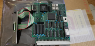

Hey everyone! I recently won an Interware VDR-1A video card. Unfortunately, it didn't come with the video out cable that attaches to the card. Does anybody have a pinout diagram of the cable, or just a picture of one so that I can make a cable for this card? Thanks!

I have the same card as you - that should help…
It´s important that you have a good 5v voltage.
Both plugs from behind - solder side :)
