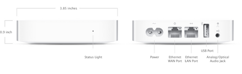

So, like one of these?
Garrett B
I have one of these, but the earlier version should work as well, so long as it can connect to your home network!
Garrett B
I’ve used it on machines with 8.6 and it works just as well as it does 10.3, which is pretty handy.
