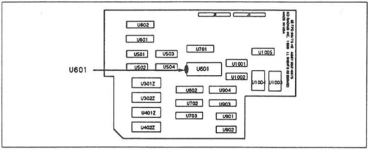

The Macintosh Plus, Macintosh SE, Macintosh II and Macintosh SE/30 only have 64KHz and or 68KHz Radius FPD Interface Cards (9-Pin Connectors). There is possibly are rare exception were a FPD SE Interface Card was made that would support 75Hz. See attached image of rare FPD SE Interface Card???
