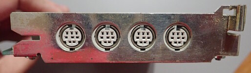

Greenspring Computers Quad Serial Model 1280 NuBus card
David Cook
Picked up this interesting card in a misc lot.
I assume quad serial?
It's a long shot, but does anyone have drivers? I can upload a copy of the ROM if anyone needs it.
- David
robin-fo
Wow, another serial card! Maybe the card works without drivers, maybe you could try the QuadraLink or CSI Hurdler drivers.
joevt
It uses two of the same serial communications controllers that all Macs use so I guess each port can do AppleTalk? Maybe the ROM has drivers that are similar to the built-in serial port drivers? It doesn't look like it can do DMA?
