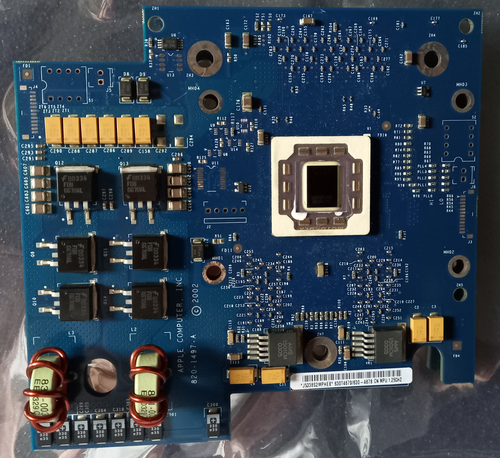

I noticed the thermal paste was quite tried off, maybe one of the CPUs partially burnt and fails to execute code. I don't have spare a CPU board to try at the moment though.

A quick look at Ebay finds this CPU card ships internationally and is not too pricey. Although shipping will cost a bit. The seller has three of them and charges only slightly more to ship the 2nd and 3rd, so if you know anyone else in France who needs a MDD CPU card you could gang together.
I don't know if that is the problem with your machine, but it sounds like you're at the point where you need to swap parts.

Any updates @mmu_man? The PSU in this MDD is a Samsung and outputs good voltages, but I decided to re-cap it anyway. After doing so, I still get a black screen, no bong, and then fans rev into over drive. I took off the CPU heat sink and WOW, the CPU was HOT HOT HOT. I'm thinking maybe a fault in the CPU or CPU module so I've purchased another CPU module (a dual 800 vs. the single 1.25 I currently have) to see if that is the issue with mine.

@mmu_man Just an FYI, the new CPU module fixed my problem. The G4 MDD boots and works great now. I wonder if the cooling on these become compromised over time with dust and dried-up thermal compound? Anyway, the dual 800 CPU module is working, though I would prefer to have a single 1.25. Hopefully you can find one soon and get your MDD up and running!
