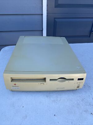

I was about to ask if it would be possible to use this board in an LC III then I noticed the 040 so it might be possible to put it into an LC 475
It uses a special video+audio i/o port on the board, so you'd have to make cables and possibly a small circuit to get the video and sound out. Doable... but not casually.

Love the reminder on that model that the power button is in fact “on/off” i.e. NOT a floppy eject button!
because DOS and Windows users were used to an eject button on the floppy drive, and they probably unintentionally shut off the computer in testing
