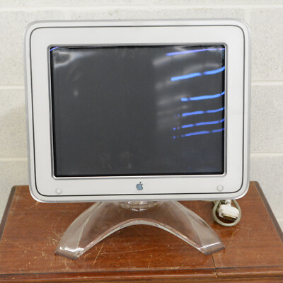

speaking of ADC Display take a look at this
Is that CRT really just powered by the 25V ADC Port? I have a hard time believing that. theres got to be AC power input somewhere on that CRT. A CRT Requires Alternating current to function!
jeremywork
Nope, all over ADC. IIRC this one can draw up to 117 watts, which *will* push the PSU over its limit if the machine already has the full extent of available bells and whistles.
Nifty950
I wanted to get that but it seems to me that if I ever have to ATX mod my G4, then that monitor becomes useless. Or if I ever want to upgrade the video card with a flashed one. Surely I could just get a trinitron and be just as happy?
jeremywork
Probably true, if you don't mind the aesthetic.
There were adapters sold by Griffin which allowed a VGA input, USB, and standalone power cable to enable use of one of these. The DVI based ones made by Apple will only work with the ADC flat panel displays.

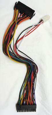

treellama
You can build a break out board: https://www.jasondoesitall.com/adc/
It’s on my TODO list for when the QS power supply inevitably gives out and I can’t run the studio display any more. (Or I might just run the QS with an ATX and the ADC with a bench supply. Or get a rebuilt power supply…)
Trash80toHP_Mini
NIGHT STALKER
Glad to see that cable is available again, even if it is implemented in straight wiring. The originals were built on a jig so as to match the twists and turns of the OEM part. I've got pics of the jig somewhere, might be useful if only for torquing the straight build into shape?

With OEM cable in hand and a bit of scaling in AI, I figure that jig would be easily reproduced. Never got around to asking for dimensions, meant to do that when his cables went out of production before I could snag a set.
