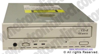

Late contribution but the Matsushita CW-7502-B CD-R drive (8x read/4x write) works in my Macs. Holding down "C" doesn't work but Command-Option-Shift-Delete does.
The tray button locations match those on regular CD drives Apple was using from Matsushita at the time.

Ah!! Turns out that the generic looking one that came in the machine I bought appears to be that very drive. 4E61F71C-BB99-4E0F-85FA-9353C753B11A.jpeg0366978A-37E5-4786-9332-89654D2A5C7D.jpeg
So you had a “Bootable 50pin SCSI CDRW Drive” all along! Lol.
