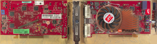

I picked this card up here from @herd a week ago, and I've been quite happy with its capabilities.
I've had it installed in an MDD/FW800 with a Sonnet MDX/Duet 1.8 and its performance complements the processor speed very nicely.
I was pleasantly surprised to find the 'top' port works as a dual link DVI port with the X850 Mac ROM, and happily drives the Apple 30" Cinema at native resolution. Some research suggests the FireGL's other port is also dual-link, but the X850 ROM would be expecting an ADC port, which were (probably) never dual-link capable. The single-link port still works great for any mode up to 164.990MHz. One of my first tests for the output drivers was an IBM T221 I've had on the bench (recent obsession) since it benefits from multiple DVI links.
For what it's worth, the 24Hz twin SL mode works just fine, and the card responds well to custom resolutions from DisplayConfigX, but the 'Detect Displays' command ends up in an infinite loop if two of the same DCX display are plugged in at once (which is how T221s work, unfortunately.) I can run either stripe at 33.1Hz, but not both at once. It's easiest just to uninstall the DCX profile for the T221 and let the EDIDs specify the output (24 or 25Hz max, depending on EDID mode.) The two stripes are less in-sync than the non-genlocked solutions I've tried from nVidia, but it's still a somewhat nicer experience than 17.2Hz. @gordan touches on a similar finding with later ATI/nVidia cards in point 5) of this post: https://www.eevblog.com/forum/gener...HPSESSID=5quoakqme3ndkc3pfhemije030#msg265450

All this aside, I would happily recommend one of these flashed cards for whatever performance-oriented G4 you might be building. It's competent enough run the 30" without becoming choppy during Quartz Extreme/Core Image effects.

Is this with the stock EEPROM or with a larger one soldered on? What ROM file was used, the one form the Wikidot Mac Elite?
jeremywork
On this example an EEPROM swap is mentioned in the original sale thread to accomodate the Apple X850 ROM; I believe the Wikidot Mac Elite was the source. @herd also had some thoughts about reducing the ROM to fit in an unmodified card, but I haven't attempted such a thing yet.
Also, to paraphrase another question: Some lower tier ATI cards aren't compatible with flashing Mac ROMs (even with proper EEPROM) because Mac ROMs expect a fully featured chip, and ATI often sold lower tier PC cards with pieces of the chip disabled (maybe related to binning defects.) If a Mac ROM could be produced with some added limitations, perhaps many more cards would become viable flash candidates.
