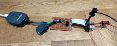

A Farallon EtherMac AAUI/10BASE-T MAU has had its AAUI cable cut and spliced onto a prototyping circuit board, where a 12V to 5V buck converter also sits. On the other end of the board is a short ribbon cable leading to a 15-pin D-sub connector, which has some power leads connected to it. A few LEDs on the Farallon adapter are illuminated.
Yes, it is. Here's a video in dazzling Potatovision that shows my adapted adapter working with an IBM PC/AT. It's hard to see the AUI connector but you can bet there's no AAUI connector there.
The AAUI connector still works if you allow the original connections to "pass through" your hack unchanged. But for AUI, it's not that simple, since AAUI usually supplies +5V power while AUI supplies +12V. The answer is to use a voltage regulator to make +5V from +12V, or what I've used myself is a cool-running buck converter like the Recom R-78E5.0 series. I've used the 1A variant, not because the EtherMac consumes 1A (nowhere close) but because I have a bunch of these buck converters handy for various projects. A hand-drawn wiring diagram is attached.
The diagram also shows capacitors connecting various "Shield" pins to ground. The standard defining AUI states that these pins must be "capacitively coupled" to Vc (which I've recklessly labeled GND) but offers no further guidance for the sake of non-wizards like me. I was not able to measure any capacitance between shield pins and Vc on a real MAU that I own, so I simply didn't fit any: the shield lines terminate on the PCB with no connection anywhere. AUI cables are allowed to be up to 50 metres long, and I'm guessing the coupling is meant to accommodate that. My ribbon cable is 5 cm long, so I'm guessing it does not matter.
