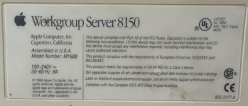

Something the seller didn't seem aware of was this sticker on the front:

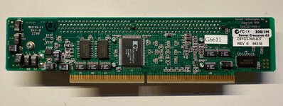

Sure enough, this was inside:
(Check that capacitor on the lower left — 😲 — luckily it was not electrically disconnected, nor was the pad torn).
Anyway, boots up without a problem; will do some investigation and recapping as necessary. Not 100% sure I'll keep the Sonnet card as my main interest is System 7.1-era software, but I guess the 300 model is one of the faster ones?
The 300 is bettter than the 266 but not an especially fast one the really good ones are 400 or even 500mhz although they are quite uncommon.
