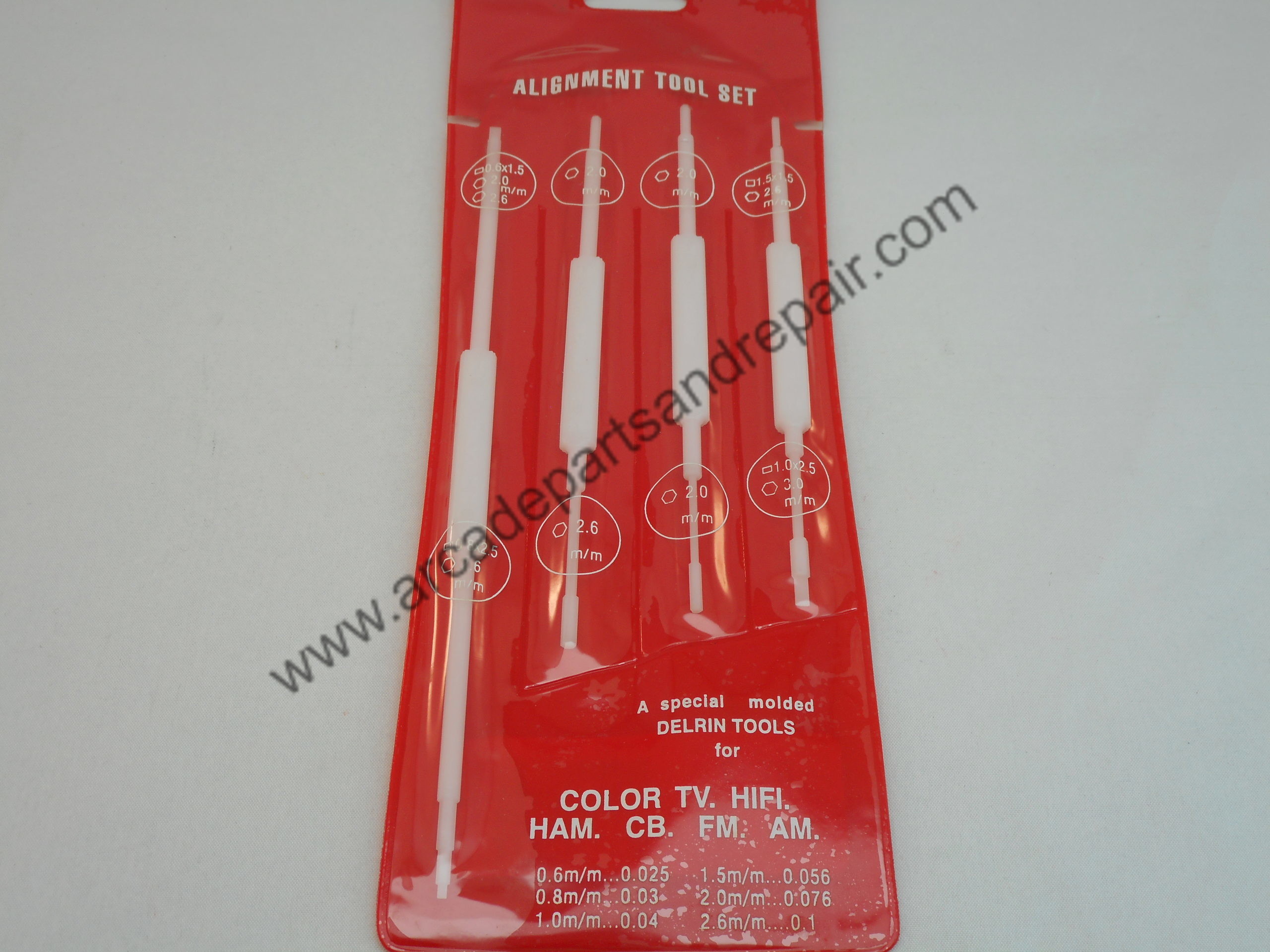

W6 is just a jumper. I belive you talking about the width coil. As long as the ferrite core isn't broken it should be okay. Make sure if your adjusting it you only use a plastic adjustment tool. If you use a metal Alan wrench it will mess with the inductance of the coil and will make the Alan wrench hot hot. It also 9 times out of 10 breaks the core, so i wouldnt do it.. Now... sometimes when they're tight (gleaned from lots of other monitors not analog boards, so take this with a grain of salt). You can heat it up a little bit with a a hot air gun (very little... don't melt it) and adjust it. Make sure to get the proper adjustment tools first.
Here is a link to a set. Maybe someone can link a better one for analog boards.
