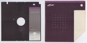

I have a full Lisa office suite in French on Twiggy disks.
My first objective would be to dump those disks in order to upload the images on archive.org and bitsavers.org. There is of course the problem that I don't have a twiggy drive, but I could lend the disks to someone that has one and would be willing to do the dump.
Then there is the question of how to dump the content of the disks : I noticed that on Macintosh Garden or bitsaver there are images of twiggy disks in dc42 format. I can therefore assume that there's a way to do it, but how ?
The second objective would be to convert those images to 3.5" format so that I could create floppies and install the software on my Lisa 2. Here again I'm turning to this forum to have advice on how this could be done. There would be also the question of deserialization.
Any suggestion ?

I have a Lisa 1 in the UK, and I dump Twiggy disks for free. The copy of the Pascal Workshop 1.0 on Bitsavers was recovered on my computer, as it turns out.
Generally Twiggy disks are dumped with the BLU utility running on the Lisa 1. The authors of BLU have adapted the .dc42 format to storing Twiggy data. This adaptation is "made up" in the sense that Apple never designed .dc42 to support Twiggy. Nevertheless, BLU's adapted format is the current standard and is used by other programs, too.
It is not likely that you will be able to run Office System 1.0 on your Lisa 2, at least not from floppy disk images. Twiggy disks hold 871k of data, which is more than will fit on any kind of 3.5" diskette supported by the Lisa 2, so you will not be able to create 3.5" diskettes that hold as much data as your Twiggy originals.
What we might try instead is using your disks (or, more realistically, copies of your disks, just to keep the originals safe) to install the Office System on a ProFile hard drive (or an emulator). We'd then take an image of that hard drive, install it on a hard drive connected to a Lisa 2, and see if it boots.
I've never tried this but I would not be surprised if it also fails to work, since the Office System 1 was created when the Lisa 2 did not exist. The software may be surprised to find the differences between the hardware of the two computers.

3. In your images I see the six Office System applications but not the binder containing the Office System OS software and manual. Do you have these disks in a different box, by any chance?

Here is the current state of the floppy disks. (See pictures).
Number 1 (the one with the white rim) appears to be in very good condition, no mold or deep grooves.
The second, (which doesn't have the white rim) worries me a little more. There are slight traces of mold but no deep grooves. However, the quality of the second floppy appears to be significantly worse than the first. In any case, it will be necessary to count on only one reading.

The disks look somewhat better than Pascal's did :lisa:
While there is localised discolouration, I'm not seeing the white crust that you find on really mouldy disks. It's possible then that what we're observing is media degradation of a different kind (oxidation, delamination, etc.), which may not be too uncommon either. I wouldn't assume in any case that the disks will be unreadable.
My experience with BLU is that sometimes it recovers itself and reads beyond tracks with bad sectors, and sometimes it doesn't. My hypothesis is that failures to recover aren't really BLU's fault. The floppy drive subsystem is controlled on the Lisa by a 6504 processor on the I/O board (in other words, a general purpose machine, not an ASIC), and the program it's running may not be robust to certain kinds of errors. So, on Pascal's disks, there were occasions where the drives would become unresponsive (sometimes the one reading his disk would be stuck spinning), and only the reset button would recover the machine to a usable state. The documentation for the floppy subsystem in the Lisa Hardware Manual suggests that it's as overengineered as the rest of the computer, so I think that it's not unreasonable to be suspicious if it.
If my hypothesis is correct, it suggests that a "BLU Pro" would be handy, something that allows you to manually specify the order in which you'd like to read sectors and tracks --- that way you can work around the places on a disk that seem to cause the I/O processor so much trouble. I've contemplated writing such a program, but it's far down on my list of things to do. Maybe someday.
