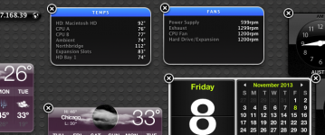

for anyone with a MacPro(or any intel mac) you can get SMC FAN CONTROL, and make it sound like a jet engine, and will drop your temps dramatically as well :)
