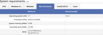

Trying to get just a little more power out of my Mystic Color Classic for Leisure Suit Larry 7
