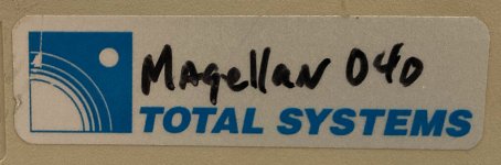

Recently acquired a Total Systems Magellan 040 in an old SE/30!
So this accelerator is a rebrand of the Donoho Design Tokamac SX. Unfortunately, I could not find drivers for either of these accelerators online, and the drive that came with card was not working. But I think we can overcome that issue. I ripped off the cover, freed the jammed drive, and was able to make a full backup!
I recovered the Magellan 040 Companion 1.7 files, which include:
Fixit 040™ 1.7
SwitchMatic™ 1.7
QuickSANE™ 1.7
Companion 040™ 1.7
After testing, I will post the files for everyone that has one of these accelerators to use, as I'm sure there's a TON of you guys out there
