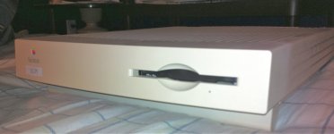

I got this yesterday, yes birthday of the mac.
I tell you what, when I opened the box and saw this beauty I was shocked.
I've yet to see a machine more polished and perfect as this one
I call this machine, The Mcdermd
He puts the same effort into every machine, try's to bring each one back
to the absolute best of his abilities.
Talk about some serious passion. Big time kudos sir.
What a great machine indeed!
Specs:
Full 68040 @ 33mhz /w heatsink
32mb stick of ram 72 pin
Ethernet Card
Custom Installed (hand soldered) ROM Simm Slot
Re-capped with precision of a robot
1 GB Hd
polished so well that you can see your teeth.
:O I think little Mcd looks better than my Quadra 630 did when it was brand new!
Can't wait to see what you do with that SIMM Slot. ;)

On the machines which will accept 128MB 72 pin SIMMs, it works, except in the PM6100. Will the P578 work with a 128MB SIMM? If so, this will probably work.
The problem in the PM6100 seems to be how the RAS lines were paired. There're four of them on a SIMM, and by separating them into groups, the SIMM can have multiple banks on the SIMM. Well, the SIMM has two banks, but it seems to have its RAS lines paired in the opposite manner to what the PM6100 expects, which is really weird because Apple paired them correctly in the Quadra models, and then did them backwards in the PM6100.
I stopped my investigations before I checked to see if the RAS pairing is configurable. There're are four tiny resistors on the SIMMs, which might be used to set the RAS pairing....
I have a 2mb rom from dougg3 on the way, this should work nicly in the LC475.

bbran has helped me out again!
Finally after almost a year. I sent my LC475 ROM BIN to bbran and he was able to remove the RAM CHECK, and he doesn't even have a LC475 either.
So i burned it to Dougg3's 2mb ROM and BAM… Instant Video! before i had to wait like 40 - 45 full seconds to see video, with that 128 meg ram simm in there.
Really nice. Next thing i would would like to try and get Hal9000 as the start up bong.
