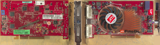

Testing the flashed FireGL X3-256MB
I picked this card up here from @herd a week ago, and I've been quite happy with its capabilities.
I've had it installed in an MDD/FW800 with a Sonnet MDX/Duet 1.8 and its performance complements the processor speed very nicely.
I was pleasantly surprised to find the 'top' port works as a dual link DVI port with the X850 Mac ROM, and happily drives the Apple 30" Cinema at native resolution. Some research suggests the FireGL's other port is also dual-link, but the X850 ROM would be expecting an ADC port, which were (probably) never dual-link capable. The single-link port still works great for any mode up to 164.990MHz. One of my first tests for the output drivers was an IBM T221 I've had on the bench (recent obsession) since it benefits from multiple DVI links.

All this aside, I would happily recommend one of these flashed cards for whatever performance-oriented G4 you might be building. It's competent enough run the 30" without becoming choppy during Quartz Extreme/Core Image effects.
