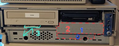

@Durosity @joshc @Bolle @MrFahrenheit @croissantking - any idea? How are the CD Drives in your 630s jumpered? Remember you have to remove the metal cover over the hard disk before the CD Drive pulls out :ROFLMAO:

To remove it, take the plastic front off the computer, remove the small metal cover from the hard disk, then lift the plastic latch under the CD drive and pull. If it doesn't come easily, wiggle it from side to side.
The CD drives just plug into edge connectors at the back on these, no cables.
