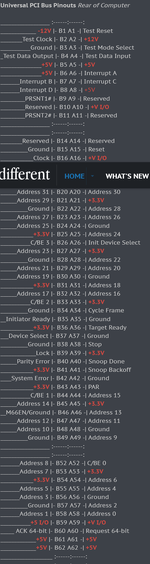

Screenshot 2026-05-11 at 11-39-38 TwiSlot PCI Riser and ComSlot2 NIC repro in widened CS riser...png
Looks to me like only 12V & -12V would be handled nicely? Those are for disk drives, no? What else?
Whatcha' think? Is is even possible to take the pressure off the TAM's pathetic 5V and 3.3V rails with an AuxPSU Hack on a new riser design?

Pathetic TAM PSU is on its own in supplying 12V and -12V to the Logic Board Riser Connector, hence to cards on riser. Target Cards for TwinSlot/TAM would be Video Card in the standard (Single Slot FatBack Riser) location with the USB/FW Card moved up and set back into the loft where the NIC would be in standard FatBack configuration. I'll post pics of the TAM test setup I did in my 6360.
Soft power came up as well, so first reaction was to heck with Soft Power, the Riser/Cards would be receiving power continuously no matter what the silly machine thought was going on.:rolleyes: Today I did a re-think and realized that it'll likely be easy enough to to a circuit on the Riser to detect 12V on its lines at startup and then begin feeding 5V/3.3V to the card stack. When Riser detects power cutoff on 12V lines on TAM shutdown, it cuts off 5V/3.3V supply, so card stack is only receiving power while the TAM is running. The little Artekit PSU will be powered up and on standby, but not the cards. Still no Soft Power tomfoolery involved!
