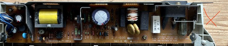

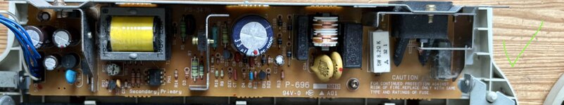

I met up with a friend whom I haven't seen in decades, at the Everything Electric Show* in Farnborough and he gave me a number of StyleWriters in various states of disrepair! There's a 2x SWIIs, an SW1200 and a Color SW2400. One of the SWIIs (a yellowing one) doesn't seem to power up (no LEDs), but the other SWII and SW1200 do. Unfortunately they won't normally feed paper through, so it's impossible to do even a test image!
