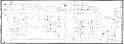

I agree that 5.2V should not be able to trigger the the crowbar but the clicking sound is very typical for an emergency shutdown in the PSU imho.
The source might for example be over current or over voltage. In the Sony PSU both the 12V and 5V outputs together control the emergency shutdown. A quick glance at the schematic give that above 6.2V at the 5V or 15V on the 12 V would trigger the emergency shutdown. A reason for false triggering could be excessive ripple due to bad filtering capacitors. Check ripple on the 12V and 5V before the filter inductors.
Put dummy loads on the 5 and 12 V outputs and temporarily disconnect the zeners for the overvoltage system. Meassure ripple both before and after the filtering inductor.
Since the overvoltage system is measuring both voltages simultaneously uneven loading of the PSU can give this type of problems. I have seen this previously in s MicroVAX 2000 which need to have a dummy load if the hard disk is removed.
