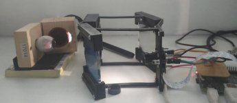

Stumbled across a great, unrelated, but fabulous project. Love the prototyping setup.
Project OWL Open Source Hardware Ophthalmoscope is 25 Times Cheaper than Commercial Products
