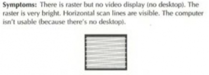

Recently I fixed a Plus AB.  Symptoms of broken-ness were:
  • Machine booted fine; could hear beep and disc activity happened.
  • Mid-grey screen with white lines across it at an angle (horizontal and vertical deflection obviously working, but no video signal).  I omitted to take a photo of this.  The Dead Mac Scrolls describes a very similar symptom as:
    but in this case the raster was not very bright, just middlingly so.
  • Occurred after reflowing solder joints on the connectors to fix the omnipresent 'intermittent video, thump it on the side and it works' problem.
