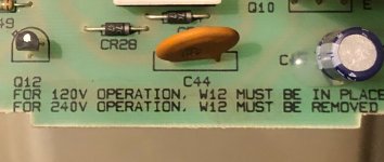

And finally, my board has the following message printed along the bottom shown in the last image

Doh!,  The spec for component Q10 on the International Mac Plus analogue board was in Addenda D of The  Macintosh Upgrade & Repair Secrets all the time, I just had to find it by using the lesser known skill of "reading"  :blink:
So yup, Q10 and Q11 there are transistors (T-NPN and T-PNP on the list on the right).  The CR400Y SCR is Q12.
