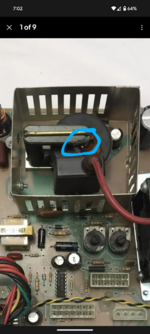

Well, my worse nightmare came true yesterday. I was using my SE FDHD playing some Arkanoid and all of a sudden the screen just went blank and smoke started pouring out of the fan. I immediately turned it off and opened the case to find the Flyback had done its last task of its life. I briefly tried to power it on while it was open and you can see the Flyback slowly arcing and burning itself even further. I've been using this machine on and off for the last few months without any sign of an issue, this literally came out of nowhere. Part that hurts the most is that it came with a Asante MAC CON SE and a bit of screen burn so I decided to buy a replacement CRT so that it would be in pristine shape. New screen was installed a few months back without issue and the Ethernet Card works as well; SIGH....

Lastly, what could have caused this, Father Time? Is there something I did to cause it? I have an SE/30 that I am now paranoid to use and wanted some tips to see if this can be prevented.

also, did you recap the analog board? I wonder if failing capacitors could somehow cause the flyback transformer to go?

Yup, the Analog Board and Sony PSU were recapped by myself. I thought that would help in the longevity of the overall system but I guess anything can happen at any time.
