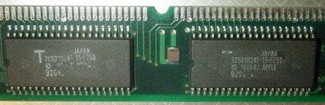

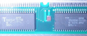

On a lark I pulled the ROM SIMM from the DOA/30 and it works just fine. Odd, I hadn't known of a 2 ROM SIMM other than BMOW's licensed Mac ROM-inator II rework of dougg3's 4 ROM. design. TattleTech says version specs are identical between types.
SE/30 (working) ROM SIMM top
DOA/30 ROM SIMM bottom - works in the working SE/30

That 2-chip ROM module looks like it's built on the PSOP chips (perhaps lower capacity though) found on the later NuBus PPC and later ROM modules.  The chips are 16 bits wide, so you only need two of them on a 32 bit wide ROM module.  The one's on the PPC ROMs are 8Mb, so four of them provide 4 MB of capacity and two of them provide 2 MB of capacity.  I imagine on the SE/30, they'd use a 2Mb or even 1 Mb capacity in the PSOP package.  It would be interesting to see what chip part numbers are under the little white stickers.
Then I'll peel one off! I'm liking the thinner, lower profile form factor. Should make for less physical interference for piling expansion crap into the PDS in its stock state. [;)] ]'> I'm currently working from gamba's info BMOW's hosting in the instructions for his Mac ROM-inator II. One's heading my way soon, so we'll see what happens.

BTW, has anyone else got an example of this SIMM?
Looks like a 1Mb Toshiba chip.  I don't know which series '53' is so I don't know if that's a ROM, EPROM, EEPROM, etc.   Doesn't really matter as the pinout is a JDEC standard, except for possible Vpp or Reset pins, but those only matter if you want to reprogram the chips anyway.  Reset pins can be a joker (some Flash/EEPROMs have them, some don't) because they must be held high in order to *Read* the chips.
Anyway, two of those gives you a 2 X 1Mb = 2Mb = 256KB ROM module (2Mb / 8 = 256KB).
That's a 20 pin PSOP.  The higher capacity chips on the PowerPC ROMs are 44 pin PSOP.

I'm just admiring an example of what I'm guessing may be an uncommon version of the SE/30 ROM SIMM. Anybody got a read on that?

Should have written 40 pin above, where I wrote 20 pin.   Counted the pins down one side and forgot to multiply by two probably.
