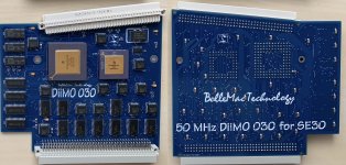

The diimo however, well, that's another beast entirely; it originally had 12 GAL 16V8 that were heavily utilized. Up to 96 Macrocells; those were replaced by an ATF1508 with 128. From a "subsystem" perspective, it has both internal and external bus strobes, data muxing/register control, cache control (and a cache snoop case for bus masters!), and internal bus cycle management. Around 36 of the macrocells in use were internal feedback only or inter-PLD feedback! All of these work together to make the thing work.

Currently, for example, I've got a case where the local bus acknowledge code will deadlock under certain circumstances, and I only have 4 test points with which to examine internal state. Tweaking the clock used by one of the intermediates seemed to do the trick with the first issue ... but it broke synchronous termination when the cache is off. And the data buffer clock on reads doesn't make sense at all; it doesn't seem to be clocking (latching) data when an 030 would normally do so at all. I have no idea how it's getting valid data!
And this is hypothetically one of the easier cached accelerators; I've already switched GALs all around on a finished board and only a couple of them are really sensitive to propogation delay. On cards like the Turbo 040 GAL version which is known to be fickle at the best of times and has a specific mix of GAL speed grades for certain speeds - godspeed.
