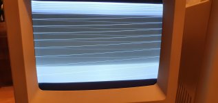

Hello,
I am looking for an advice about my problem with the SE 30.

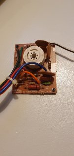

The picture shows analog horizontal lines. Looks not like an error from a digital part. I have already washed the board completly in the dishwasher and after some research about this problem I have also completly replaced the analog video board that is fixed at the end of the CRT tube.
When the Mac starts i can hear the start ing sound and the bad image appears directly.
What can I do to identify the problem?
Thank you all very much in advance!
Best
Roman
View attachment 20200610_003045.mp4
Yeah, but he’s got no video at all. That’s exactly what you’d see if the video signal weren’t hooked up at all. It’s not just the cutoff.
The bong is very quite.
I have also read about the UE8. What can I do to test it or do I need to replace it directly?

The video output of the logicboard is stuck in the on state. It’s all white pixels that you’re seeing on the screen. The scan lines are visible because the beam never turns off. That’s caused by a fault in the video logic somewhere... bad counter, bad UE8 - something along those lines.
