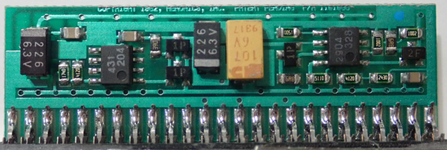

APPLE ACTIVE TERMINATOR
First, Apple psyched me out with this fantastic soldered shielding. Fort Knox.
How disappointing. It isn't a fancy chip. It's just a voltage regulator.
The TL2217-285 is a fixed voltage regulator whose preset voltage is purposefully made for SCSI termination.
Backside is the standard resistor array and some capacitors for the regulator. So, unfortunately, the Apple Active Terminator is nothing special.
Aside: I hope this is no-clean flux because those pads look a little gross.

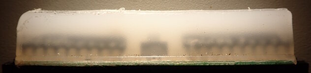

Our last hope is the eBay import internal terminator. Surely a more modern implementation will feature a fancy chip!
Removing the black outer cover reveals the circuitry is encapsulated in plastic.
It would require a lot of digging to remove the plastic. I'm not sure the parts would be readable. But, clearly that's just a voltage regulator in the middle with the standard resistor arrays on the side.
In summary, all three of these active terminators have the same type of circuitry. None of them are special. The Apple and Granite had shielding. The import's plastic dissipates heat poorly.

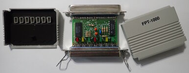

Another active terminator arrived in the mail today. This Interex FPT-1000 has slightly better circuitry.
The inside of the plastic case has spray-on shielding.
The 74F04 logic chip is a hex (6-pack) inverter chip. It simply provides power to six of the seven LEDs based on the SCSI logic lines. The middle LED displays terminator power, and thus can be driven directly from that power source.
What you don't see is a resistor pack. Instead, the REG5601U includes a regulator, on/off switch, resistors, and noise clamp all in a single package. The Interex PCB included a place for a physical switch. I guess that's only populated on the 'premium' model. : )
Here's the instruction card that came with it.
The thermal and current limits are probably part of the voltage regulators we've seen on other terminators. And, frankly, they should never kick in under normal circumstances. The novel part of this terminator is clamp portion of the circuit.

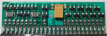

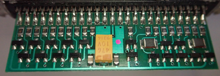

Here is an unusual terminator, in regards to the quantity of discrete components used.
Top of board. Looks like capacitors to locally store terminator power. Voltage regulators on left and right??
Bottom of board. Transistors?
Angled to better show the connection to pins.
220+550ohms across 18 parallel pins = 30.55 ohms. 5V/30.55 ohms=0.163 A * 5V * 2 terminators = 1.63 watts
Correcting a typo. I dropped the 330 ohm resistor and skipped to the sum. This should read:
220+330=550 ohms across 18 parallel pins = 30.55 ohms. 5V/30.55 ohms=0.163 A * 5V * 2 terminators = 1.63 watts

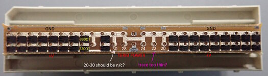

I purchased one "Apple Macintosh Internal SCSI Termination Block for II, IIx, IIfx - 590-4515" from ryancook11 on eBay. It was overpriced, but I was interested in taking it apart to see if it is anything special. It is not.
The label says "Internal SCSI Filter, Ma" 590-4516 (slightly different than title, but matches eBay pictures) 9022 DM553-02-CAPS. This does not match Apple part numbering and it does not have any Apple branding. I don't know who manufactured it.
It comes apart by hand and is easily reassembled. Left-to-right: cap, female connector with attached PCB, frame, and keyed female to male extension/adapter.
The circuit board is flat. It appears to consist only of traces and printed resistors. So, a passive terminator.
I have three thoughts about this design:
1. The trace around terminator power seems a little thin. Notice GND and other portions of the terminator power trace are thicker. However, only 80 mA is flowing through each branch.
2. Pins 20, 22, 24, 28, and 30 probably should be n/c instead of ground. A lot of terminators ground these pins, therefore it must not be a big deal.
3 How well do printed resistors dissipate heat and age compared to surface mount? The terminator cap fits loosely; exposing the resistors to air. I guess this is no different than most potentiometers though.
