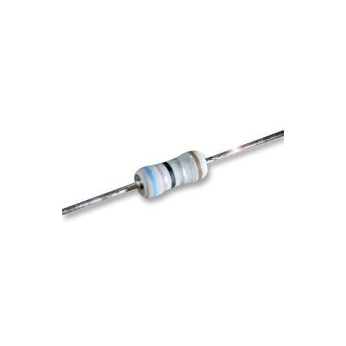

  • I've done a thorough visual inspection of the board and top side of the components, but I haven't actually checked the 1Ohm resistor at R4 with my multimeter. I've noticed in the following picture that it could in fact be burned out, so that's my next port of call. What wattage is this part supposed to be, 1W? (look near the mains connector / fuse).
Thanks for posting. I was struggling to find the fault on my own PSU until I saw your post. And of course R4 was in the Mega ohm range, with a tiny scorch mark. I've ordered a replacement.

I’m sorry for forgetting to update this thread previously - after replacing both the PWM controller and fusible resistor, the PSU is working happily again!

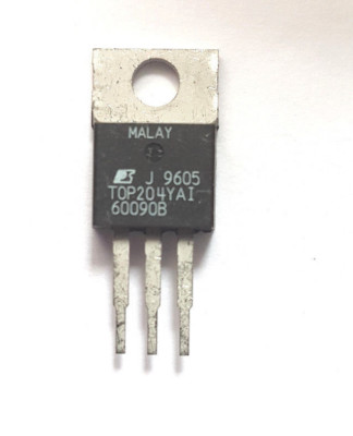

The PWM controller IC is a three-pin TO-220 package, I think it's IC1 near the fusible resistor - mine had failed short-circuit. Something will have caused that resistor to blow, so you need to find the cause of the issue before replacing the symptom - R4 is fusible for a reason.
The original part is a TOP200YAI, which as you can see from the datasheet is only designed for 0-25W applications.
I fitted a TOP204YAI as a replacement, which is rated for 75W-150W applications - I'm not sure whether this will make it more or less reliable in this specific application, so I'm not saying you should fit a TOP204YAI instead of a TOP200YAI, it's just what I did.

Thank you so much. I pulled the TOP200YAI and it did appear to be shorted. I've ordered a TOP224YN as a replacement as I think it looked like it should more or less do the job as a replacement. It'll be a week to so before the parts reach me to try it out.
