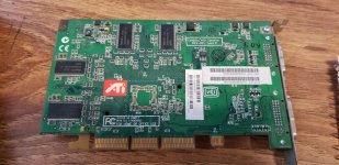

Now I also have an ATI Radeon 9000, which also appears to be an OEM card pulled from a later G4. I got this card last year, but I have never gotten a video output at all with computer monitors. Aside from one occasion that it was able to boot into Mac OS 9 while it gave a video output. It was able to run Quake 3, and it was beautiful. To this day, I am not sure what got the ATI card to function on the Sawtooth on that one occasion. I have not been able to recreate it, and it still doesn't work with the Datapath.
After these two cases, I suspect that my G4 has some slight issues with graphics cards. I have tried resetting the NVRAM in both cases, but no results. Is there anything else I can try? I do happen to have a non-functional G4 Cube with a Rage 128, though I am not quite sure about extracting the card and fitting it into the Sawtooth.
