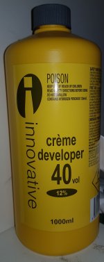

What formula did you use? I found "Hi Lift 40 - 12%" creme at Chemist Warehouse that seems to work well. Seems to be the same as the Salon stuff that 8bit Guy Recommends, but I'm unsure.
Could go to priceline, they sell a 1L 40vol 12% bottle for $12 I believe. Could go to a beauty supply store, one not too far from me charges $4 for 1L but I dont know how they work, dont know if they sell to general public.
The UV lamp is phillips normal UV - I bought it from Masters before they closed down. The globe is form Bunnings. Temp doesnt matter.
I used Colour Royale Creme Peroxide 40 from Hairhouse warehouse.
