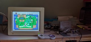

Briefly summarizing my original thread, I have been trying to find a way to display (non-Apple) retro video games on the Apple CRT monitors I already have. I started off (successfully) connecting a SNES to my IIgs monitor, and then attempted to (unsuccessfully) connect my Wii to my Macintosh II monitor using a GBS-8200. My current goal has been to find a way to drive my (Sony Trinitron) AppleColor High-Resolution RGB Monitor using modern/alternative hardware.

No problem! Here are all of the pictures that I took while working on this project.
