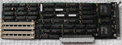

Thanks to @NeshireChoir I finally got the Rasterops Accelerator a 12" NuBus card. Looks like Rasterops made 2 versions, I and II in the same year (1990). I have version I and found quickly what was wrong with version I. It was not designed to be put into compact Mac II like IIcx or IIci. The top cover can't be closed, only if you cut/breake the clip that holds the NuBus cards when the lid is closed. (See bent chip from top left side on picture below). I have filled the card with 4x 30 pin 4 MB SIMMs.
Rasterops Accelerator I (pic /ilike8bits.com)
