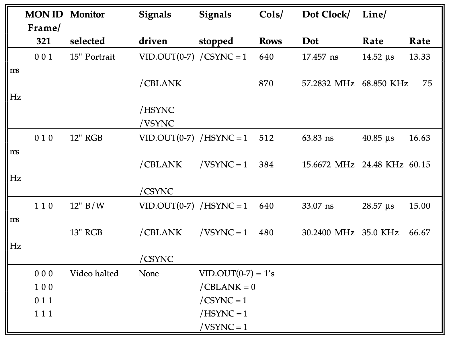

I checked the DB-15 video connector pins with an oscilloscope, and I do see a signal on the red, green and blue pins. However, CSYNC and VSYNC are both stuck at 5V and HSYNC is always at 0V, which seems odd. I found a nice reference on how the video output works here: https://www.bigmessowires.com/2023/...d-designing-a-mac-to-vga-adapter-with-lm1881/.
Does anyone have a clue what might be going on and what I can try next? Some tips on how to debug the video issue are also appreciated.
