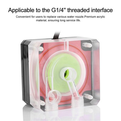

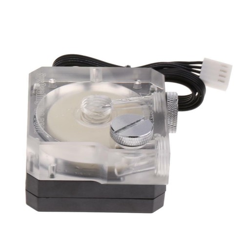

After some trial and error I have the Syscooling SC-P60A pumps installed - they are a similar design and output to the OEM Delphi pumps but shorter in height, they are mounted on ~ 25mm high density EVA foam blocks and adhesive foam to reduce noise and vibration. The Syscooling pumps are of good quality and sealed design.
With bench testing, so far so good - the pumps work quietly and while bleeding the system for air bubbles can take time, having a small inlet port to funnel in coolant in is rather useful. I've used a small fan controller and found they keep pumping without issue @ 3 - 12V, but are quiet so will just leave at 12V unless the loop requires more slower water flow for adequate cooling (assume analogy of pumping a garden hose through a straw).
Next up is to run them off 12V in the Quad and see if I can calibrate the Mac without PVM sense lines; these pumps are PWM but I'm quite sure Apple's implementation of this won't be the same.
Fingers crossed - I'm just happy to be gone of the Delphi pumps which really are junk. I've watercooled PCs for years (in the early days that was getting parts from the aquarium for my Eheim pump setup!) and these pumps are simply the worst in terms of design and you could never be confident that they wouldn't leak.
