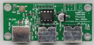

PS2ADB is a stand-alone utility device for use with any ADB-based Macintosh computer, allowing use of very inexpensive keyboards and mice, including optical mice, with any Macintosh that has an ADB port. PS2ADB is powered by @tashtari's TashTrio PIC firmware, which was announced back in February. We're working on a 3D-printed enclosure, since there's exposed +5 volts DC on the bottom of the PCB. We'll be releasing the schematic for it in the near future. With market prices for second-hand ADB keyboards, in particular, seemingly on a seemingly-unstoppable upward trajectory, PS2ADB is a low-cost solution to enable new entrants to Mac collecting to use input devices they may already have on-hand.

View attachment 43279View attachment 43280
