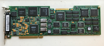

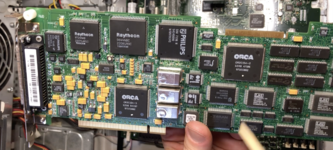

Media 100 Vincent 601 video editing card:

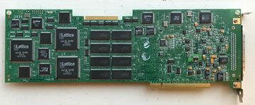

Here's some screenshots of the MDD units and more shots of the gigantic Media 100 Vincent 601 video editing cards, and a shot of the Twin Turbo 128 too.

Here are shots of the massive (12-1/4" long) Media 100 Vincent 601 video editing cards:
Media 100 Vincent 601 front
Media 100 Vincent 601 back
From the small amount of research I've done, the Media 100 Vincent system were used in non-linear video editing, and was a combo of the above processing card and outboard gear for capturing from source and storing produced video. It appears the Vincent 601 systems were supported up to OS X 10.4 Tiger.

And measuring the two Vincent 601 cards I have they measure 12.25" long from circuitboard front to back (a bit longer if you count the slot hardware).
