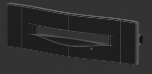

If i get some time i'll try to make a bezel for the floppy drive. My biggest hurdle is all my floppy bezels are intact and I'm worried that if i take one off to measure it, I will end up breaking it. I should be able to measure all the things I need without taking it off though.

Turned out to not be a whole lot of work, so here's a Quarda 800/840av Powermac 8100/8500/9500 etc floppy bezel!  I haven't actually tried it on any of my machines (all my floppy bezels are intact), so I can't guarantee that it will actually line up with the floppy drive 100%. As far as I can tell with my measurements it should be (at the very least) close enough, but just be aware that you might be wasting time/plastic/money if I made a mistake somewhere.
But anyway, good luck and hopefully this helps!
View attachment 815-1521 floppy bezel.stl

Ok Floppy bezel ordered and received from ShapeWays and it is a perfect fit on a PM8100.  Awesome work!

Not a problem at all! I had the bezel pretty much modeled anyway, so adding the floppy features wasn't too much work. I'm just glad Glad it fits - thanks for being the guinea pig!
