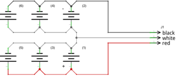

this is an excellent question, and i have no immediate answer. I will lay a multimeter on the wires as soon as i can sit still. In the meantime, here is a schematic of the PDQ PRAM battery.
It seems to want +3V and -3V and their awful solution was with six 50mAh units
Indeed they seem to want 150mAh (per side, 300mAh total) which is an awful lot to me.
In the nineties, most cells were 3Volts. Which makes replacing this wiht modern units really complicated.
I think it is feasible to replace all of this with two VL3032 (3V 100mAh), but before posting a howto i'll do it on my own PDQ and confirm the method. We're losing 50mAh but I really doubt this power is used anywhere (I might be wrong).
Nowadays, most rechargeable cells a 3.2V (sometimes 3.4V), swapping with those could lead to unpredictable results.
You can't swap with coin cells (non rechargeable) without adding diodes, and even so, this could lead to even more unpredictable results
I think 2 CR3032s or a pair of CR123s would probably work. From the schematic above, it seems to want positive on the red wire, negative on the Black, and a voltage half way between the two on the white wire(virtual ground). So using a pair of CR2032s/CR123s (assuming they are 3.2V each) in series, the red comes off the plus side of CR2032 #1, the white is on the connection between the two CR2032s, and the black is on the negative of CR2032 #2. Alternatively, a 6V lithium (2CR5, 6V @1500mAH for example) cell/battery can be used, with a pair of resistors making up a voltage divider network to create the "virtual ground". I still don't see the need for 4 or 6 coin cell batteries. I suppose a set of 4 AA or AAA batteries in a holder could be could used, but now we are defeating the purpose of making the PRAM battery pack smaller.
